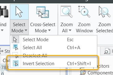

I little confused here whether ask is For Creo View or Creo Direct (CEDM)?
If ask for having inverse selection option for Creo View, then it already do have Inverse selection option (as shown below):
