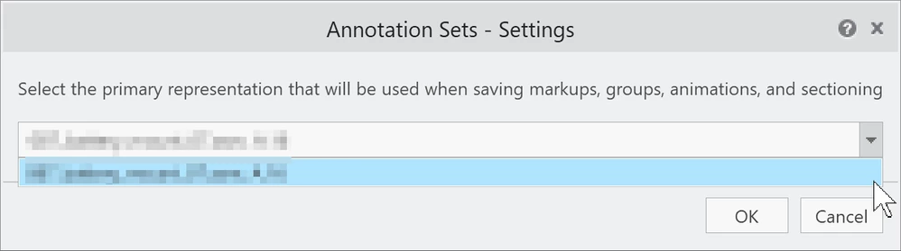

PS: I believe that the problem occurred after this dialog suddenly appeared, which I quickly clicked away with o.k.:
I can no longer tell if there were multiple options to select from at the time, or just one option, as in the screenshot above (the two pixelated lines in the screenshot show the same file name, namely that of the parent file in this case).

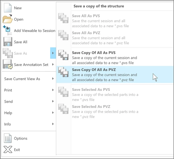

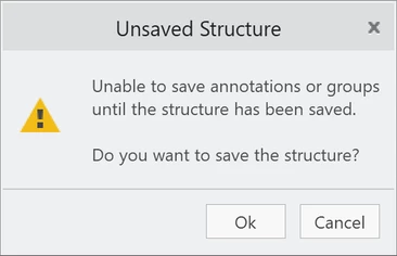

Now I have recreated the combination of the parent PVZ file and the viewable, added to the parent file.
When I then save the parent file, the following message appears:
This means that the added viewable is not saved in the parent file.
If I then save the combination of parent file and added viewable with "Save Copy Of All As PVZ" (other saving options are not available)
...then the added viewable does get saved in the parent file.
However, now the annotation sets created in the parent file are lost from the new combination file!
So how can I save a parent file along with an added viewable from within Creo View, without losing the annotation sets already present in the parent file?

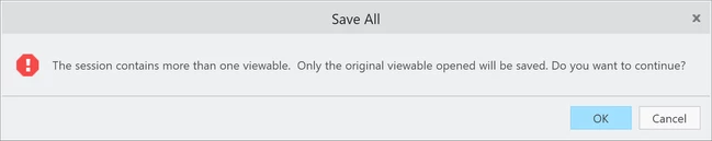

Also, when I close the parent file (with the viewable embedded in it), the below message comes up, and when I click OK, the message comes up again, any number of times:
In conclusion, this means that the file can no longer be saved at all, neither by Save As, nor by Save All.
Something seems to be seriously broken with Creo View's loaded viewables and annotation sets functionality.
July 5, 2022
Doing the combinations of saving/editing structures, adding viewables and saving annotation sets at the same time is flaky.  My workaround is to perform save as to new PVZ file frequently.   The save all you have in your image I have found to not be reliable.
