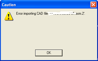

April 26, 2013
um, it's Creo 2.0, they stripped all the functions.
my Isodraw is the same.

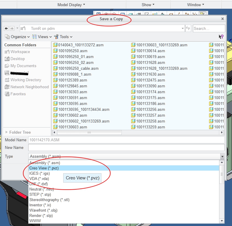

April 26, 2013
We just switched (on Monday actually) from IsoDraw 7.1 which we used with asm files to 7.3, f00 and are again using asm files.
Can you attach a screen shot of the following window? Open IsoDraw, go to Help > About IsoDraw... (last option in menu).
April 26, 2013
In Creo 2.0 go to "Save As", "Save a Copy".
