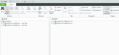

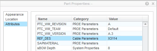

Hi all,
Is there a way to point my customized callout to the ASM instead of the PRT? The connector number metadata that I'm attempting to target is in the ASM (highlighted in structure) and not the PRT. Please see my annotation and screenshots below.
Tom

May 5, 2022
Currently the assembly node must have geometry for a callout to be created at that level.
There is an idea for this enhancement already:
Exploded Assemblies item tags - PTC Community
If you haven't already I would suggest adding a vote for it.
