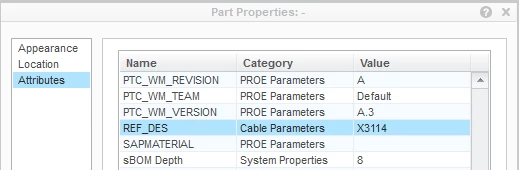

Hi all,
Is there a way to edit my customized Creo Illustrate callout to point to the ASM part attributes instead of the PRT part attributes? I'm working with a model that has the connector number metadata that I'm attempting to target in the ASM (highlighted in structure) and not the PRT. Most of the models I work with have the connector metadata in the PRT file and my custom callout works fine. Is there a way to modify the XML to get this to work? Please see my annotation and screenshots below.
Tom
My annotation to reference "REF_DES":

Hi Marc,
I found a workaround but not a solution. My memory isn't the clearest, but essentially what I did to accomplish this was by highlighting the .asm and .prt in the BOM and editing the structure so that they're combined. It was good enough for what I was working on. I hope it helps you out.
