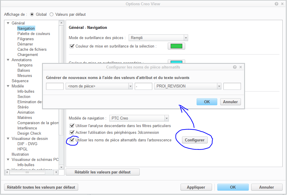

hello Hervé,
it is an option available in CREO VIEW only:
cheers
Ron

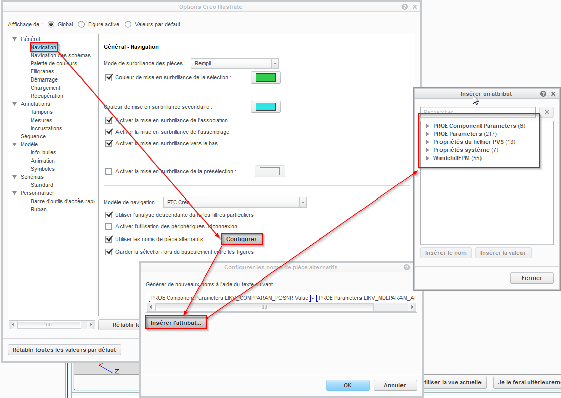

April 27, 2016
Hello Hervé,
Like in CreoView (ronan idea), you can did it in CreoIlustrate :
2-Explorer
April 27, 2016
Exactly
