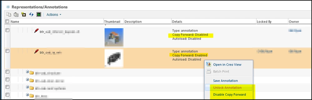

So I have marked up a model with annotations and notes.
The engineering has recently updated from rev A to Rev B.   Is there a way for Creo View to update the engineering while still keeping the annotations and groups of the previous version.
Or is there a compare function I could do that would compare part numbers vs the location and have another PVZ of the changes B had to tack on to Rev A?
October 31, 2022
"copy forward" is the functionality you are looking for to bring the annotation forward as the model iterates/revises.   Manually manage it as shown in image below.  I don't know if you can compare a model with markups...

So I have to release It to windchill and that function actually happens through windchill then and not in Creo view itself?
