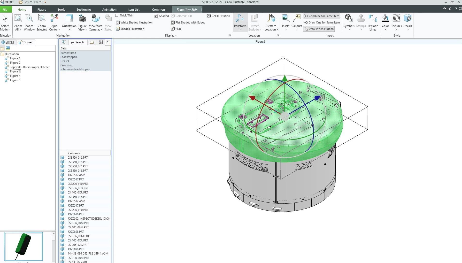

Can anyone help me with this: In Creo 10 Illustrate, I want to move the anchor point to rotate. See a screenshot below; This contains a group of opbjects that should rotate not from the center point but from a another point so that the hinge effect is more visible.
I may be overlooking something on how to move the anchor point in this version of Creo.

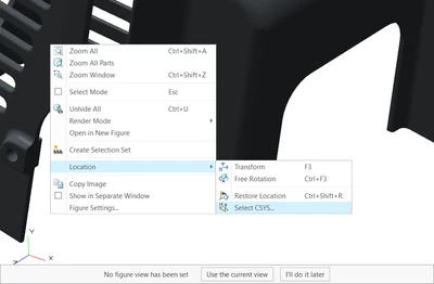

August 24, 2023
The option to set the rotate axis has not moved.
You will find it in the RMB menu under Location (note that Transform needs to be active):

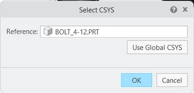

This allows you to pick a part, edge, axis etc to use as the csys (rotation point).
Hope this helps.
