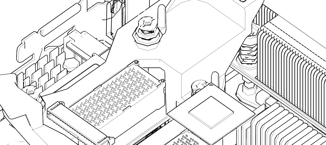

I'm having an issue with circles importing into Illustrate 3.0 as hexagons. For one particular assembly it worked fine on my laptop (HP workstation laptop), but imported as hexagons on my desktop. Today I opened another assembly and it imports incorrectly on both devices. They all open just fine in Parametric 2.0.circles_to_hex.PNGIn this image the top middle screw should have circular washers and the spring, a little to the right should be a circular helix.

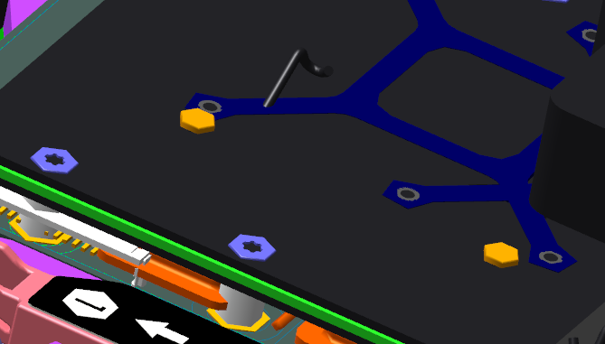

circles_to_hex2.PNG Here, the hexagons, and squares at the end of the blue shape should all be circles.

I tried saving a geometric rep of the assembly as an .ed Creo View file and it imported corrected. Everything looks right so far.
