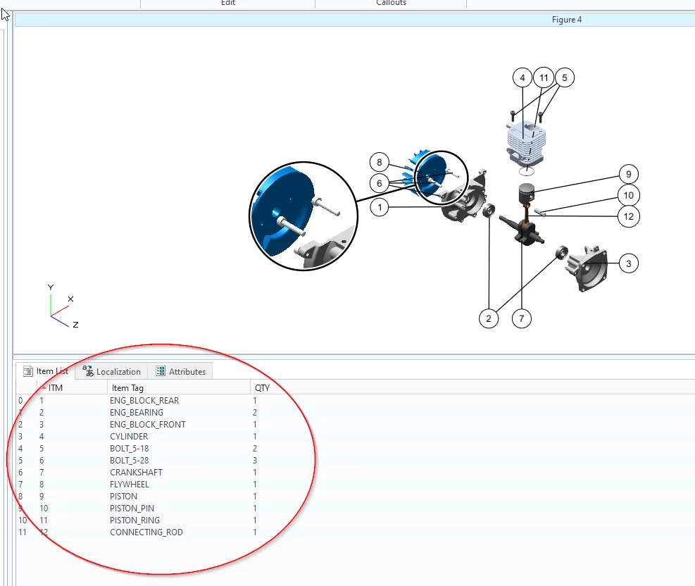

Hello
CREO Drawing module fails to me with respect ease of use when creating assembly instruction. I consider using some extra software to hekp me make those instructions faster. There is Creo Illustrate. So far I found it intresting however I was told it does not create bom tables nor help to manage/edit/modify them. This is big issue to me and big miss. Second one is a price wich for annual period is bigger than my CREO Essential package proce (missing only AAX, ISDX, BMX,)
did any one of have any experience with Illustrate or any other software?
Innoptus_Ferry
February 28, 2020

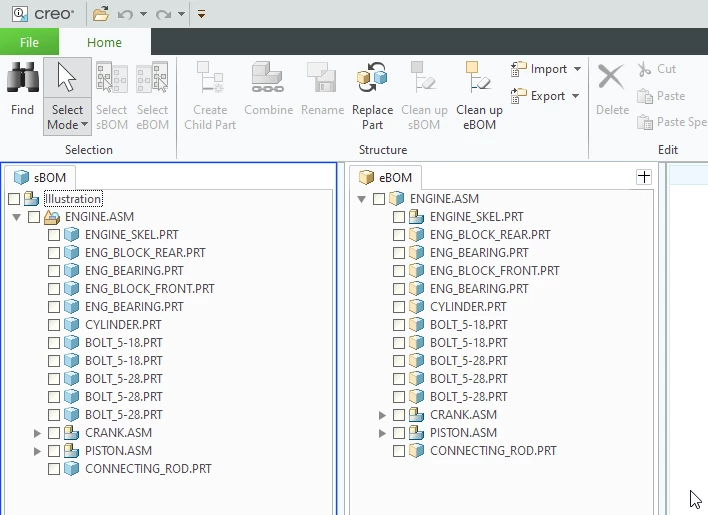

Hi
With the Creo Illustrate Standard License software you are able to edit the eBom/sBom.
You aslo have an Item list witch can be used as BOM list.
Pricing is one you should discus with your reseller.
BR
Ferry
