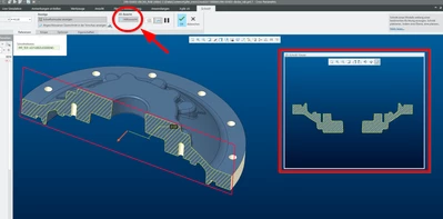

Hi Mwolfe_mn (why nobody has a real name here in the forum?),
I haven't seen this function in Creo Illustrate yet. I only know the button from Creo8:
In my opinion, at the moment this function wouldn't make much sense in Creo Illustrate either, right?
So, I suspect this is a mistake in the Creo Illustrate online user manual!?
