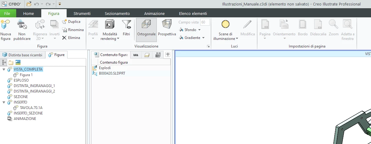

Hello to all,
in the illustrations I create, I have the Page Setup icons always turned off. (see Attachment).
How do I enable them?
Matteo
Best answer by mtoreskog
In Creo Illustrate 7 you need to define the sizes in the preferences (File - Options) and save it to the standard.
mtoreskog10-MarbleAnswer
November 11, 2020
