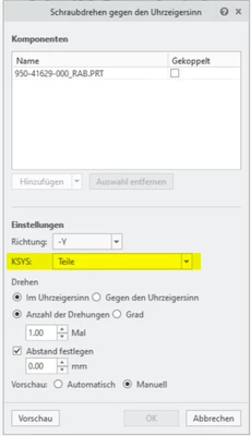

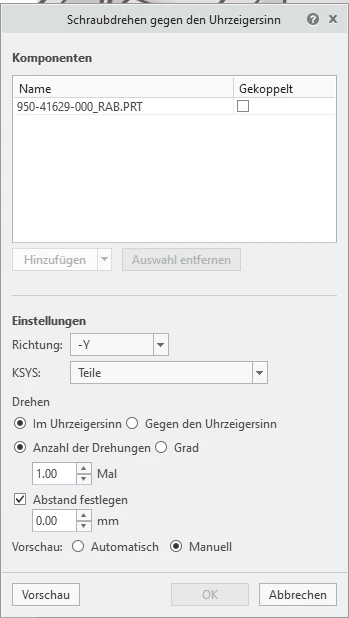

Hello all,
I would like to animate a crank rotation. For this I use the effect Screw Turning.
Unfortunately, the crank turns around a wrong (default?-) axis (red arrow). I would like it to turn around the axis of the green arrow.
I have already tried to select other coordinate systems, but it doesn't change. Does anyone have any advice?
Thanks and greetings
Ramon

Hello, let me introduce how I write about this problem.
First, combine the green arrow and the rotary handle to coordinate by the arrow, then record the animation and delete the arrow animation.
I don't know if this is the best way, but it's easy to use.

Although this workaround should work, you shouldn't need to add a symbol in just to achieve the desired result.
I would suggest this is a good candidate for an enhancement idea on the forum.
Creo View / Illustrate / Schematics Ideas - PTC Community
Attaching the image and video you have here would be very useful as it explains nicely the problem you are trying to solve.

Hello agarland,
if you say that this is a good candidate for an enhancement idea, then that would mean that there is no solution to my problem at the moment!?
That would mean that the "coordinate system" entry in the screwdriver effect does not correspond to the desired rotation point. Is that so? And if so, what is the purpose of the "coordinate system" entry?
But if the "coordinaten system" is the rotation point, then it is either a programme error or I am doing something wrong (but what?).
What now?
Best regards
