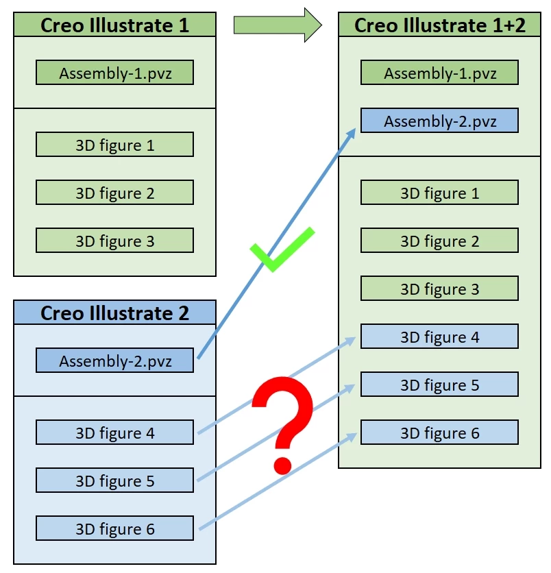

In general, the question I have is whether I prefer to work with isolated Creo-Illustrate files for large projects, or preferably just one, where I combine everything together.
The problem is, of course, that Creo-Illustrate files are getting bigger and bigger and thus harder to handle.
My example:
Let's say I create two separtate Ci files (Ci 1 and Ci 2) for two different pvz files (Assembly-1.pvz and Assembly-2.pvz).
In each Ci I create for example three 3D figures (3D figure 1...3 and 3D figure 4....6).
After some time I realize that it would make more sense to have only one Ci instead of two.
So I copy for example the Ci 1 and name it Ci 1+2. Here are now already the 3D figures 1...3 included.
Then I import the second pvz, i.e. Assembly-2.pvz.
So far, so good.
Here is my question:
Is it now possible to copy (transfer) the 3D figures 4...6 from the Ci 2 to the new Ci 1+2?
Or do I have to recreate the 3D figures 4...6 in the Ci 1+2?
Attached is the schematic view for what I would like to see.
Thanks a lot and best regards
Ramon

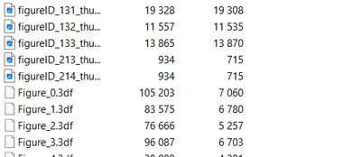

In short - when you open the c3di file as an archive you'll find PNG images of the thumbnails of the figures, .3df files which are xml files describing everything about each figure and a single "manifest.3di" xml file which combines all the other files and sort of structures them I guess.
I think you have to unzip the target, copy the corresponding PNG and .3df files to the folder (with already changed numbers at their end, otherwise you might overwrite some illustrations), edit the lines in targets manifest.3di:

Edit the red numbers. Always 3 per figure. Assign them the same numbers that you're going to assign to the PNG and .3df files. They must correspond and must be different from the ones used in target file.
You can now find the last figure in the targets manifest.3df file by the same means - ctrl+f and so on but this time you want to paste everything from the opened and altered notepad you've created in previous step. Right behind the last "/>" end of line tag.
Now you need to close the manifest (save changes!).
Now remove the old archive (which you should actually have done right after you've exported its contents) and zip the whole target folder. Change the file extension to c3di.
