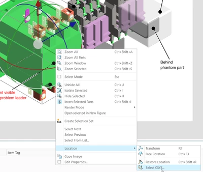

You can reposition the csys using the 'Select CSYS' option in the RMB menu.
This will allow you to align select a centre line or other axis to position the csys on.
Depending on what exactly you wanted to animate this may help.

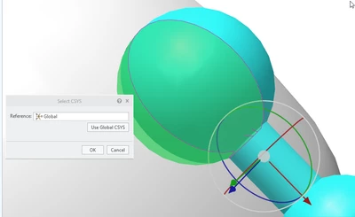

Hey,
Thank you for a quick reply, I've already tried this option but it does not work in this case. I have a sphere where I can't select any axis, center line or edge to create csys 😞

Have you checked that all your construction geometry is visible:
If it is then I think you'll have to look at your recipe file for generating the pvz from Creo, as it looks like it's stripping too much out.
