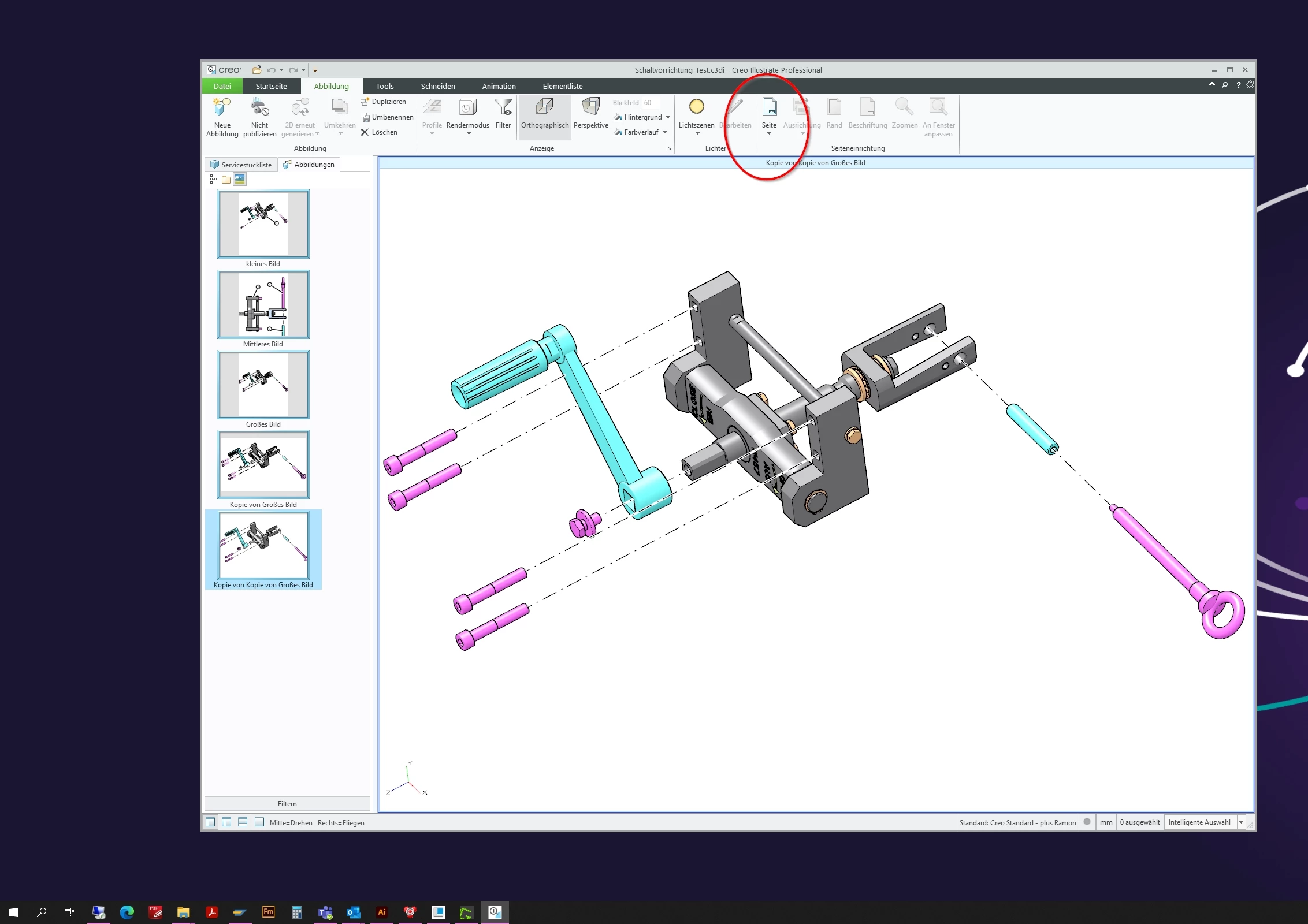

unfortunately I have a next problem:
I just noticed that when I export images, the stroke widths are different when I make a display with and without page setup.
So far I have always exported images by fixing the model in the window and then setting the desired image width (e.g. 17.5 cm) with resolution 300dpi (118 dots per cm) when exporting. The result is an image with a pixel width 17.5cm x 118dpcm = 2065 pixels.

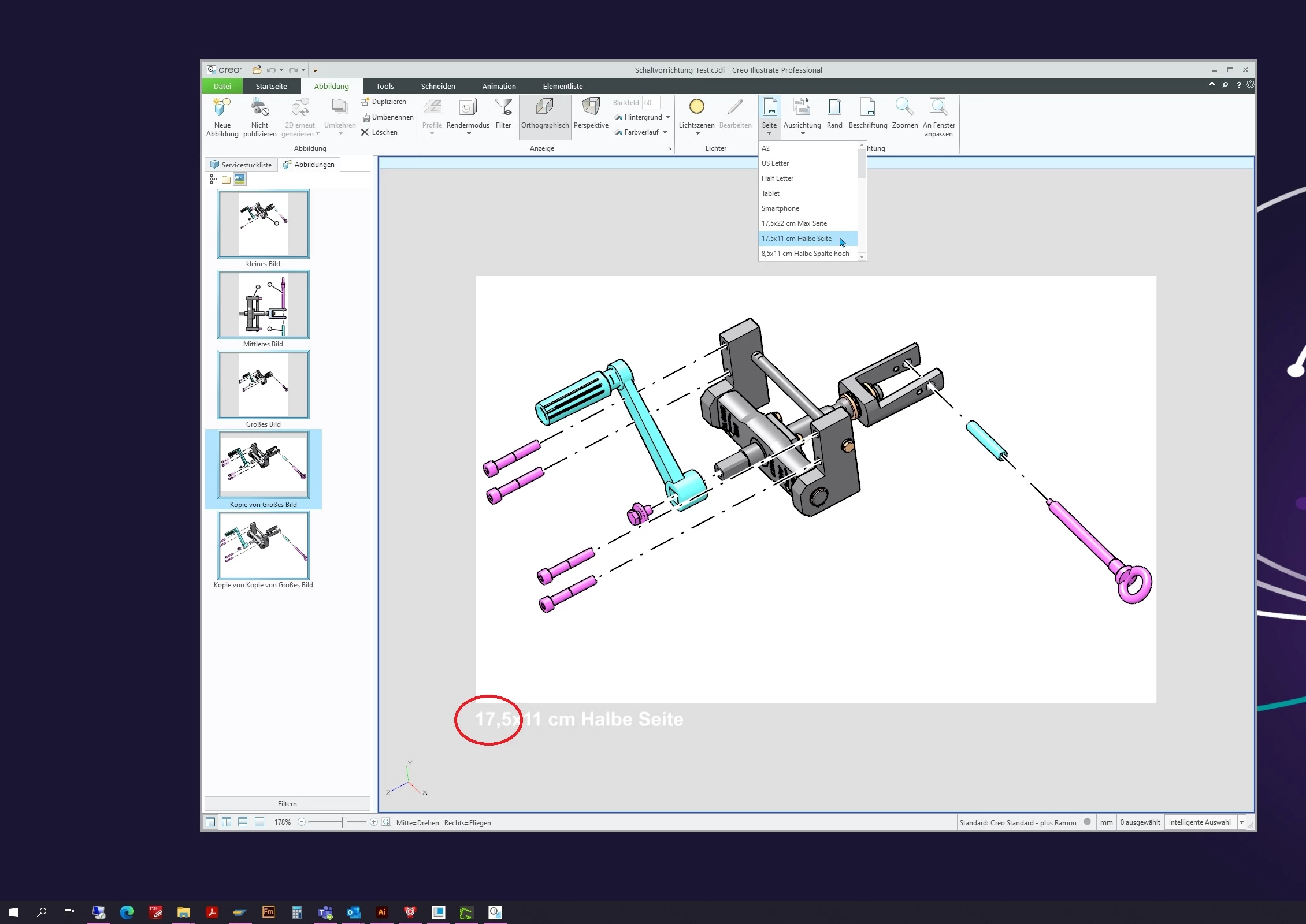

In the meantime I found out that it is more convenient to define a page size. And that you can define your own page sizes with the administration tool. So I defined a page with the dimensions 17,5x11cm and set it later.
When exporting the image I only had to set the resolution 118dpcm and I also got an image of the pixel width 17,5cm x 118dpcm = 2065 pixels.

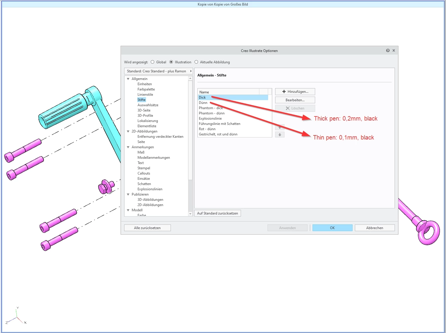

So both images are the same size in the result. For both images the pen thicknesses Thick = 0,2mm and Thin = 0,1mm were set.
Problem:
The exported line thicknesses are different. The exported image with the predefined page setting 17,5x11cm has unfortunately much too thick lines.

In the 3D figures the line weights are shown in proportion to each other, adding a page shows the line weights in proportion to the page size.
This is why you are seeing a slight difference when not using a page.
For the most accurate line weights we would recommend using a 2D figure as this always shows the physical line weight values.

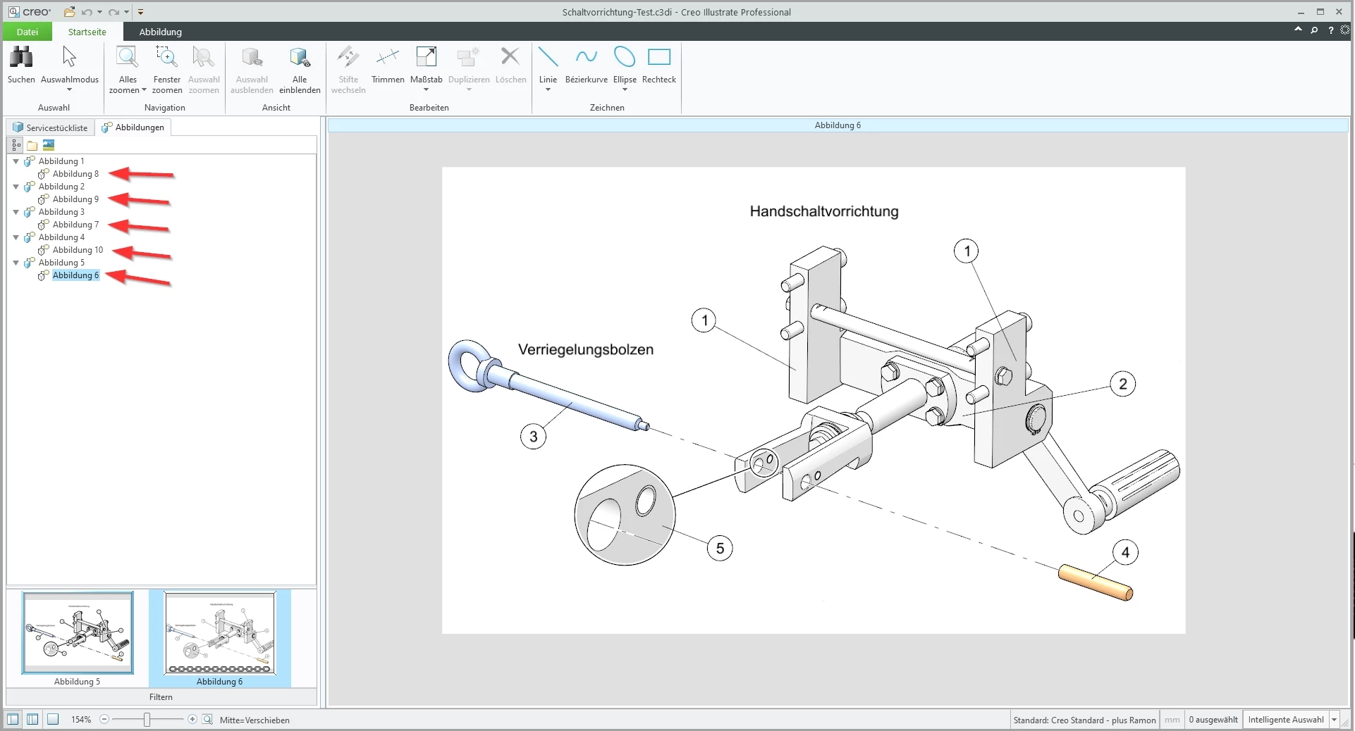

so I need to add a 2D image to each of my 3D images!? Is that the way you recommend me to do it (sorry for asking, but I need to define my further way of working)?
To be honest, I tried it and it works very well 🙂  And it also helps me to solve problems with partial views and break lines (that I can insert in the 2D image).
If I will work this way, it will also solve my request "Creo Illustrate Image arrangement, size and export" (April, 11.).
I have attached a picture of my Ci and pdf-file to show my very satisfactory result with an example.
