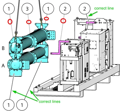

Ramon_Bohne
January 9, 2025
Hi JHollis,
thank you for confirming the problem with the line settings.
And I have just opened a CI file and I have this line setting problem again:
Four of the seven lines have lost their setting! That is @#!@##! 😞
