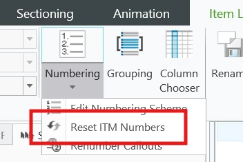

There is an option to reset the item numbers after you have deleted an item though.
This will reset all the item numbers to be sequential again.

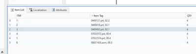

I took one of our simpler assemblies and copied our SBOM to the ITM List, sorted it by PN and renumbered the ITM list (Items 1 - 6)

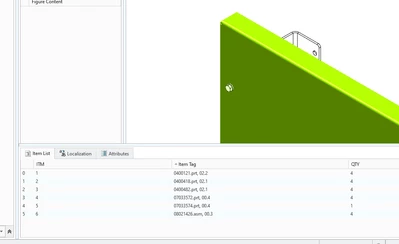

If I delete all four washers, (Item 3)
The ITM list shows Item 3 deleted.
After I "reset ITM Numbers", it changes the sequence number back to what I originally dragged/dropped from the SBOM, minus the washer that I deleted.
Then I will need to renumber the ITM list again.  Not so bad when I only have a handful of parts, but a real pain when some of our illustrations have over 100 items.
