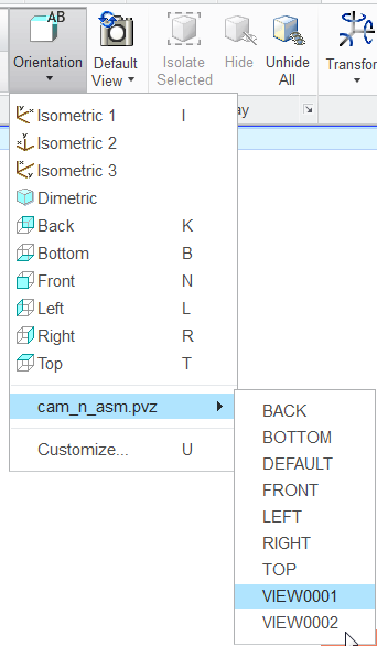

When we opening an EDZ (exported from Creo) file in Creo View we see the views that engineering has created in the orientation menu.
When opening the same EDZ file in Creo Illustrate those view are not present in the in the orientation menu.
Is this a bug? Feature? Or am I missing something?
September 17, 2013
I'm not sure this is a feature or a bug. Certainly it is what we experience also. Similarly if you export the annotation sets, in Creo View you'll see groups for each Simplified Rep. In Creo Illustrate you won't. Oddly however the explode states appear to be selectable at the Illustrate level.

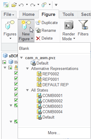

I Think i am wrong, bumped into a ptc express post 9 tips for creo illustrate 2 that notes you can make a new figure from a rep
September 19, 2013
Creo Illustrate 3.0 now allows you to re-use Views and Alternate Rep's from the source data.
