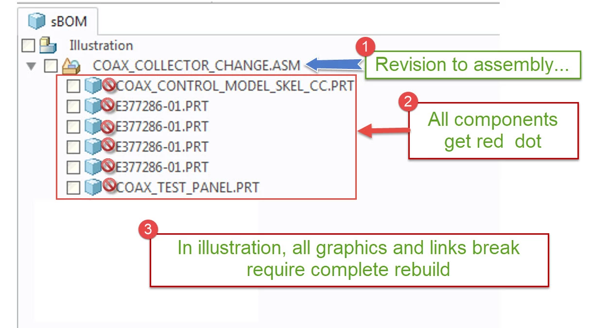

Currently we import PVZ files into Creo Illustrate to produce operation steps and associated graphics and annotations.
This works very well until we receive a new updated PVZ.
When the new updated PVZ is imported, many of the links break requiring graphics and annotations to be rebuild.
For example, importing an updated PVZ where a sub-assembly has a new revision results in broken links and requires all graphics and annotations for each operation to be rebuild.

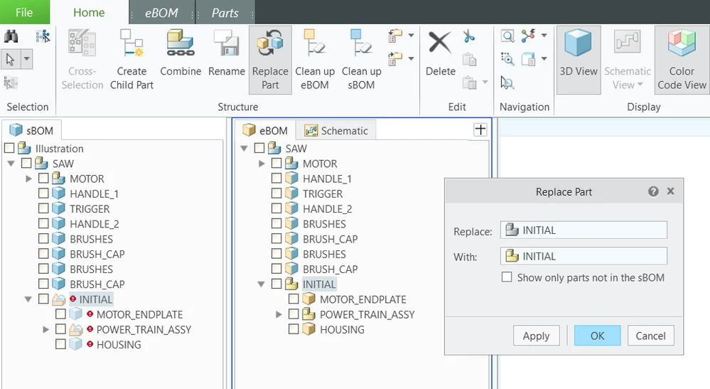

I would recommend using the 'Replace Part' option in structure edit mode.
Select the parent node with the missing link in the sBOM, then click on Replace Part in the ribbon.
Then simply select the replacement part in the eBOM and hit Apply.
This should replace the parent and child nodes, depending on what exactly has changed of course.

> is it only the children of an updated .asm part that are marked as missing link and is that asm the top node?
  It is NOT the top assembly. We bring in a top assembly that has a revised sub-assembly. All links to components in the revised sub-assembly break.
Hope this helps.
