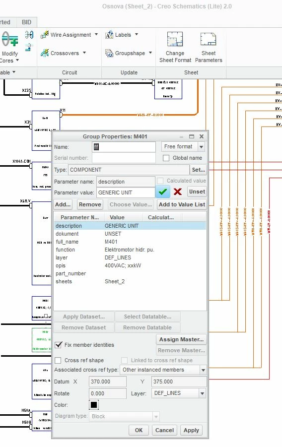

in our company I'm using Creo Schematics 2.0 Lite M010. Everything works fine until we updated Windows 10. We have updated Windows 10 to version 1809 (this worked on 1703). From now on I have a problem when I start to input parameter's value for symbol or label because always there is inputed two characters on start.
Example I start typing t but in inputed are two t's (tt).

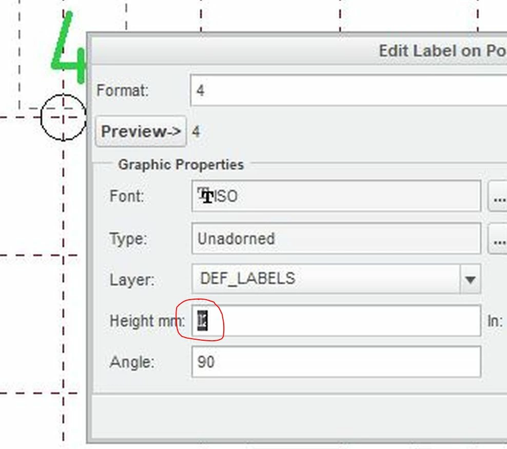

I've also noticed that sometimes are inputed unknown characters (on attached pictures) .
Am I only one that have this problem? Can you suggest what could be wrong?
T.
