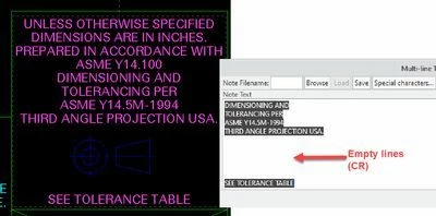

It is case # 17526068.  There was a spr #15744978 issued for it as well.   I have narrowed it down to multi-line text in the original format.  It appears that the system handles new multi-line text however the original multi-line text that has been in our format for over a decade is what failed.  We may need to explore what changed about the multi-line text between CS 4.0 and CS10+.

For anyone that comes across this issue, the problem lies with multi-line text that has empty lines in between the text as shown in the attached image. The system will crash in CS 10+  when exporting a PDF. You will need to break these down into separate notes without empty lines until this is repaired.
