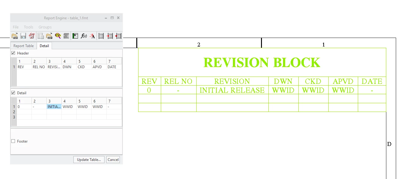

Is it possible to wrap text or fix the cell size in a report engine? I am trying to create a revision block for a drawing utilizing the report engine. The user would just have to alter the presets to apply their information. The picture attached shows what I am intending on doing. Currently, we have to adjust the cells and remove borders in order for it to appear correct.

As far as i know you can't wrap text or fix the cell size , but in Creo Schematics  the width of the column in table is adjusted automatically according to  the longest value ..... so values should always appear inside the cell ,
according to the image, it seems you are using text as values for the table, you should consider using sheet parameters for better management.
