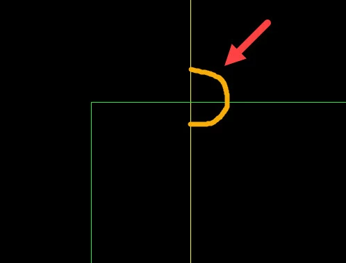

New Creo Schematics user. I'm trying to add a jump or bump to show cables that are not connected.
Anyone know a procedure on how to go about doing it?
Thank you
Best answer by KC_10522311
Hi ASA,
There is a button called "add crossover" in the diagramming ribbon.
7-Bedrock
June 21, 2023
Hi ASA,
