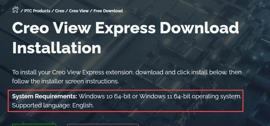

Creo View Express is a free version of Creo View that is only available on Windows. The system requirements articulated on the Creo View Express Download page
