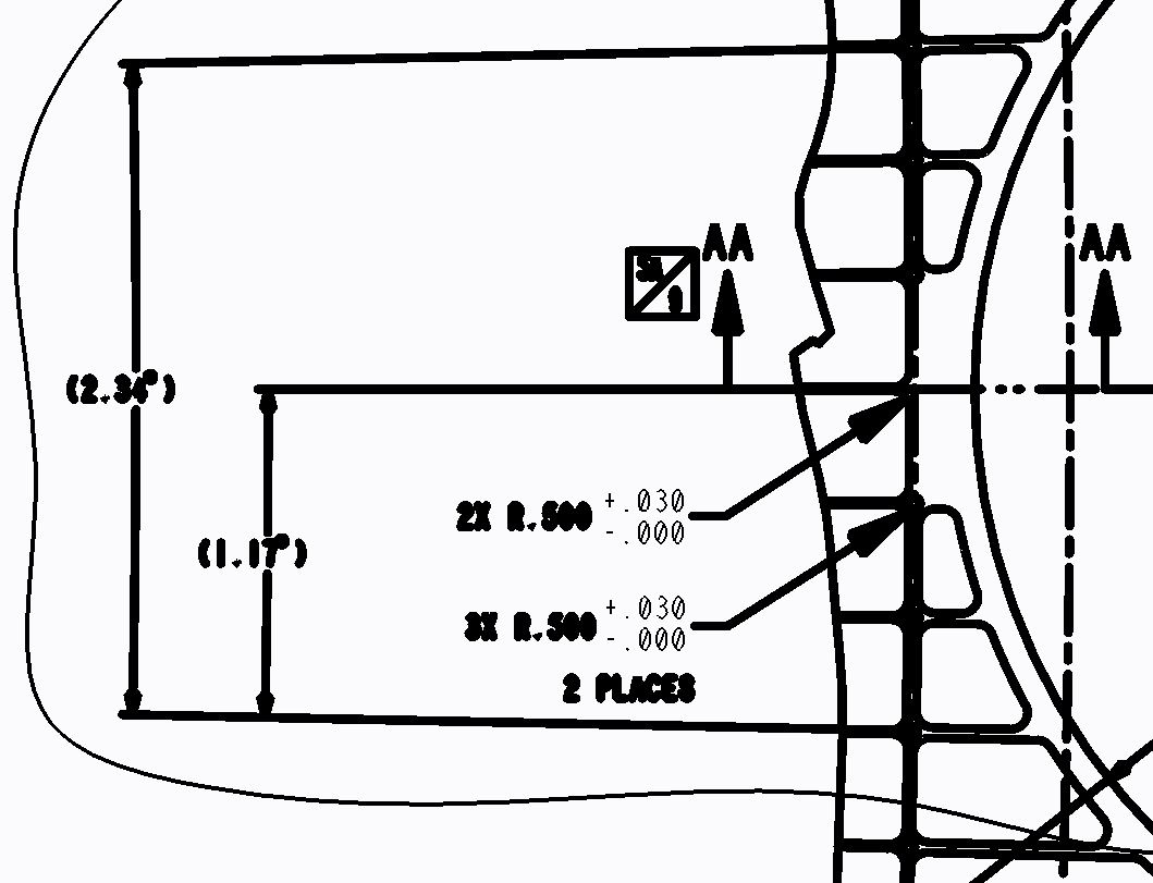

Anyone know how to control the line weights of sketched entities or entities imported on a drawing as DXF entities in Creo View? All of the Creo View entities look great with the exception of these. They appear to have a line weight of roughly 10X of everything else on the drawing in Creo View. However, when viewed in the Creo drawing itself, they look identical to regular items on the drawing.

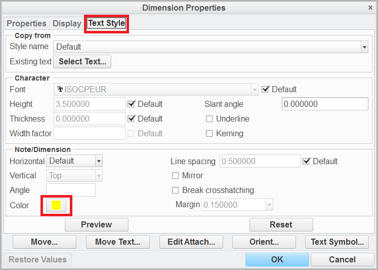

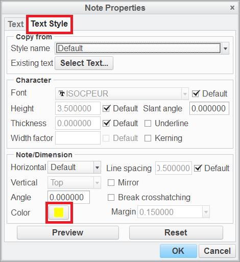

doubleclick 2X R.500 callout. You will get Dimension Properties dialog box or Note Properties dialog box.
Click Color button on Text Style tab.

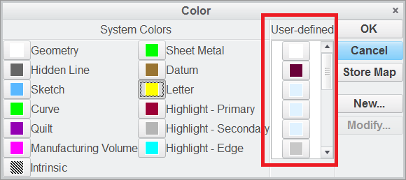

I think that in case 2X R.500 callout you will see yellow color selected in User-defined area. If this is true, then 2X R.500 callout is printed using pen 1 (all user colors are printed using pen 1 !!!).
Change 2X R.500 callout color to Letter (I think Letter color is assigned to +.030 tolerance) and create PDF. What is the result ?
If result is expected line thickness of 2X R.500 callout then now you know that all DXF entities are colored using user color .
MH

This image is of the Published data in Windchill The text next to the 2X R.500 callout is actual text with a line weight of .000 placed on the drawing. The spline to the left of the (2.34) is a sketched spline with a line weight of .01. Everything else is imported DXF data from the real Pro/E drawing.
