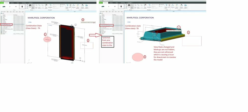

When a Model Checker provides Markup in Creo view for a MBD CAD model in an specific combination state (View State) then the markup is displayed in all the other combinations states (View states), This is creating lot of confusion while reviewing the model and unnecessary markups getting displayed in other combinations states (View states).
Is there a workaround which will allow the mark ups to hide when we switch from one combinations state (View states) to other.

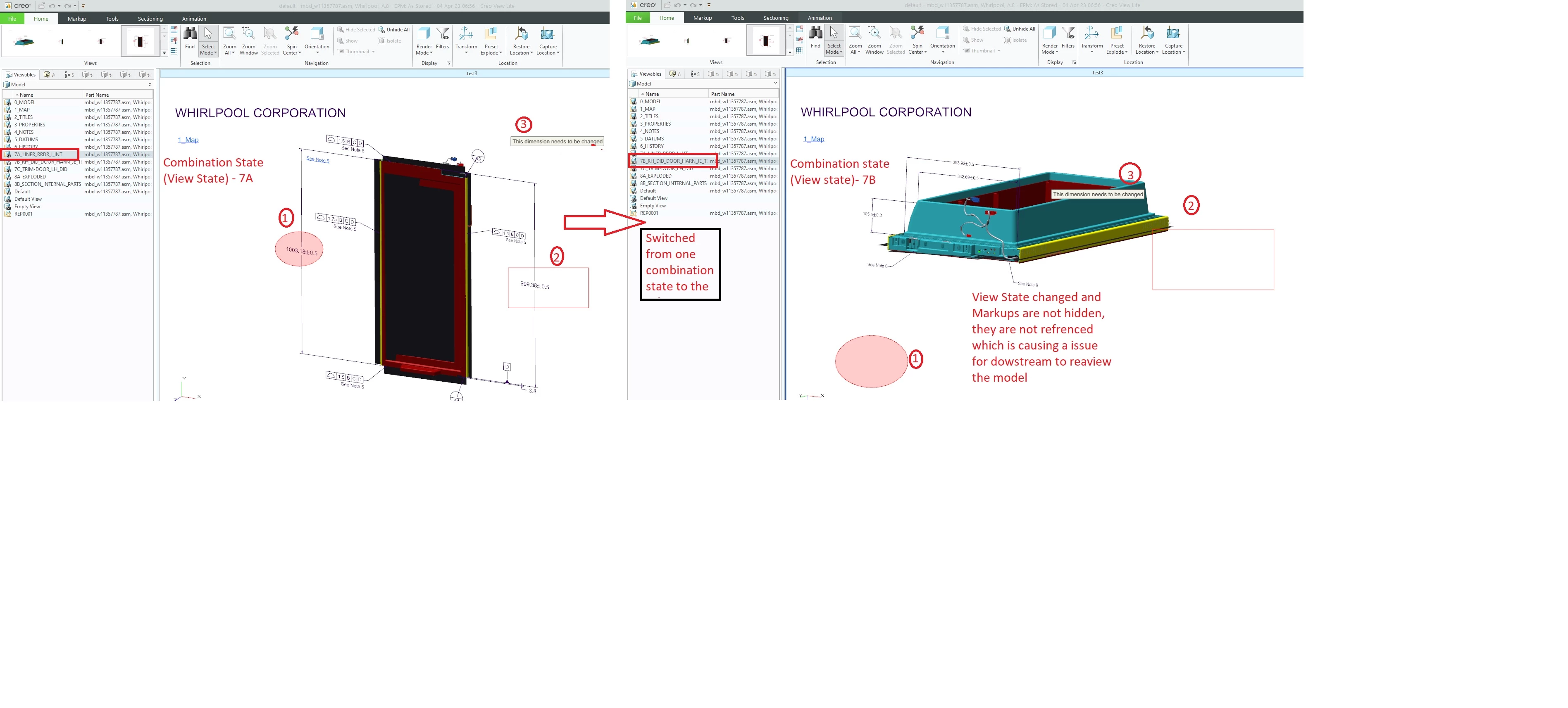

I am taking the liberty to bring your image to more visibility, to facilitate finding an answer on your post.

Hi
Annotation Set are created on active view. Changing active view are considered as change in annotation set, where markups are placed in same view with changes.
View state activation triggers change in view - so existing markups as kept as is from view state.
I would recommend raising product idea - as this needs product improvement to for requested behaviour.
In mean time you can possibly use following options:
- Close active view of annotation set (using cross button in top right corner)
- Select view state that you desire to open, RMB -> Replace View -> Select active view.  --> This will close the annotation set and replaces it with selected view state
