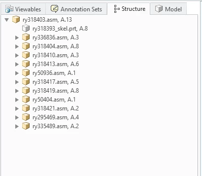

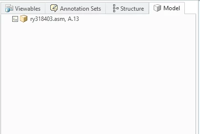

I have an assembly opened in Creo View and all of the sub-assemblies show up fine in the structure tree. However, in the model tree it will only show the top-level assembly that I have open. I would like to select parts in the graphic window and have them highlight in the model tree, like how it works in Creo Parametric.
I have tried reloading the branch links of the top-level assembly in the model tree, and the next level of sub-assemblies' link correctly, however as soon as I go to the structure tree and come back to the model tree, all of those links disappear. If anyone has any ideas how to fix this I would definitely appreciate it!
Best answer by BillRyan
If you click on model tab and look at bottom of the panel is there a "filter" box shown?  I'm wondering if you have a filter applied.
BillRyan16-PearlAnswer
September 11, 2024
September 11, 2024
I thought I had my filter settings set up correctly, but I did not, so that fixed it. Thank you for helping me!
