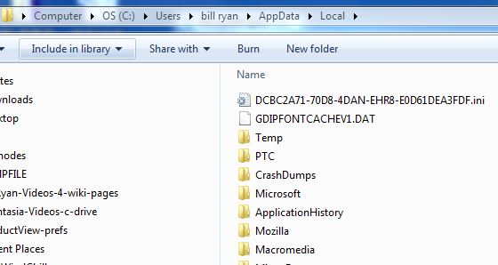

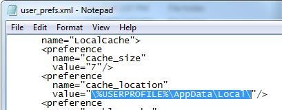

Ok...so I'm tyring to modify the XML file for user preferences so I can distribute to other user's and have their cache set up and enabled.  What is the line of text I need for the value of cache_location?  I've tried about 10 different variants without any luck.
I'm trying to go here...

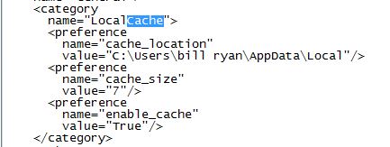

Thanks Martin and my friends at Leyland for helping out...the work around I found was to leave the value for cache location unset as shown below.  With Cache enabled, the file path gets generated on Launch of Creo View and saved into the XML file upon exit.   More testing would need to be done for this be set on the server_prefs.xml or admin_prefs.xml per CS32479, but for me to hand it off as a user_prefs.xml file this will be sufficient.
Initial Settings as shown below in user_pref.xml file
After user launches and exits, the XML file gets updated as shown below.

some notes ...
1.]
\%USERPROFILE%\AppData\Local\ ... you have to remove first backslash, its presence doesn't make any sense
2.]
I didn't find any information describing format of user_prefs.xml file. Therefore I don't know, whether variables are allowed inside it. You can ask PTC Support.
3.]
In config.pro, variable notation (Unix like) is ... $USERPROFILE ... you can try this notation in user_prefs.xml file
4.]
If user_prefs.xml file distribution is performed when user launches Creo View, then you can include a script into Creo View startup sequence and replace variable in user_prefs.xml file by its real value.
