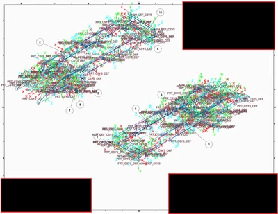

I'm trying to roll Creo View out to some pople within our company but don't want to without getting a few things ironed out. One being the publisher. Why does every job with the publisher fail! Has anyone got a way around this? Number 2 see attached, CYS and planes show up when opening Creo View out of both Windchill and ThingWorx. Anyone have a solution for this?

Since CreoView is publishing every job to an internal content as a .pvz file, which is a PDF embedded with other attributes. You need to adjust the Creo configuration on the publishing machine to turn off datums and csys so they don't get published with the object geometry or drawings.
As for the publisher failing, how is it failing? Is it timing out due to the complexity of the models/drawings being published? You can adjust the timeout times in the recipe file, but also may need to adjust the timeout preference values with xconfmanager settings.
I have these lines in my config.pro on the publishing server:

Preference settings that may need adjusted are:
Xconfmanager settings for publishing:
Publish.cadtimeout.assemblies 3600
Publish.cadtimeout.component 600
Publish.cadimeout.drawing 600 or 1200 (this will depend on the failure timeout value and may need increased even more)
In the recipe file set the following timeout values
Short 600
Long 3600
