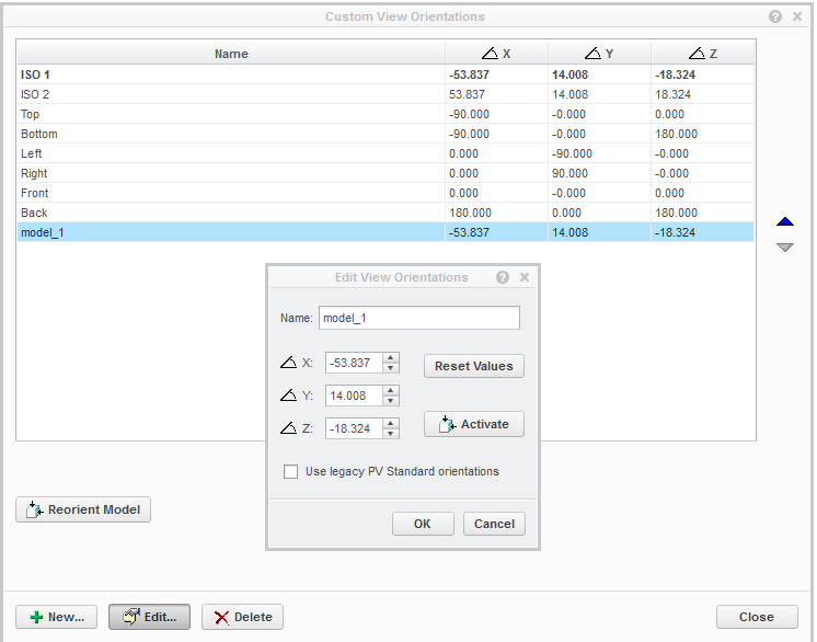

I have a problem when adding a new orientaion view.
It will not add the shown orientation only the default.
Thank´s in advance.
Mia

Your Admin could have the view creation locked. Are you trying to get something like the attached image?
mbrorsson1-VisitorAuthor
April 14, 2016
Before the values from the shown view were following when rotate model.
Now it´s stucked at default and has to be added manually.
As you can see from picture model_1 has the sam values as ISO 1 (default).

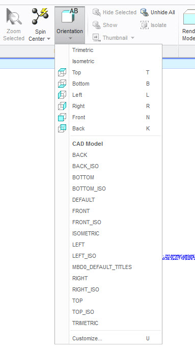

April 15, 2016
If you have admin rights on your computer you can just add it to the admin_prefs.xml in the loadpoint\preferences\Productview.
Add this in the code under this section  <preferenceList name="ViewOrientationsTable">
Change the last value line to the view name desired from "DEFTop" to "DEFXxxxxxx". You have to have DEF before the name.
      <preferenceItem>
        <preference name="locked"
                    value="false" />
        <preference name="IsXYZ"
                    value="true" />
        <preference name="DegZ"
                    value="-53.837" />
        <preference name="DegY"
                    value="14.008" />
        <preference name="DegX"
                    value="-18.324" />
        <preference name="OrientName"
                    value="DEFTop" />
      </preferenceItem>
