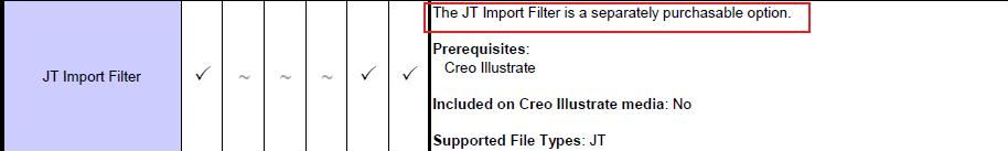

From Unigraphics you can transfer files to Creo Illustarte only in "JT" format, in this case, you must separately purchase an additional option "JT Import Filter". "PRT" file format designed to open models (parts) created by Creo / Elements Pro (Pro/ENGINEER) and it's not a UG NX file format.
December 2, 2011
Peter,
Further details of these optional additional adapters are available here:
http://www.ptc.com/products/creo/view/adapters
