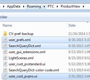

I would eliminate the settings files as a possible issue...there are three of them that can get loaded.(server, install dir, user directory)  If you have Cache enabled...you may want to clear it.

Finally discovered the issue.
The xml file for server preferences in the Visualization Configuration Administration at the site level was very large.  Removing unnecessary properties and reducing the file size fixed the issue.    Users must also clear the browser and creoview cache.
October 14, 2015
check out SPR 4591120 which talks about preference file size.  You may also want to watch out for the size of the user_prefs file.  I'd be interested to know what type of information was being stored in the server side preference file that caused the file size increase.  What we found in the user preference file was the branch link information...which I believe yields better performance for finding the location of the metadata on the server.
