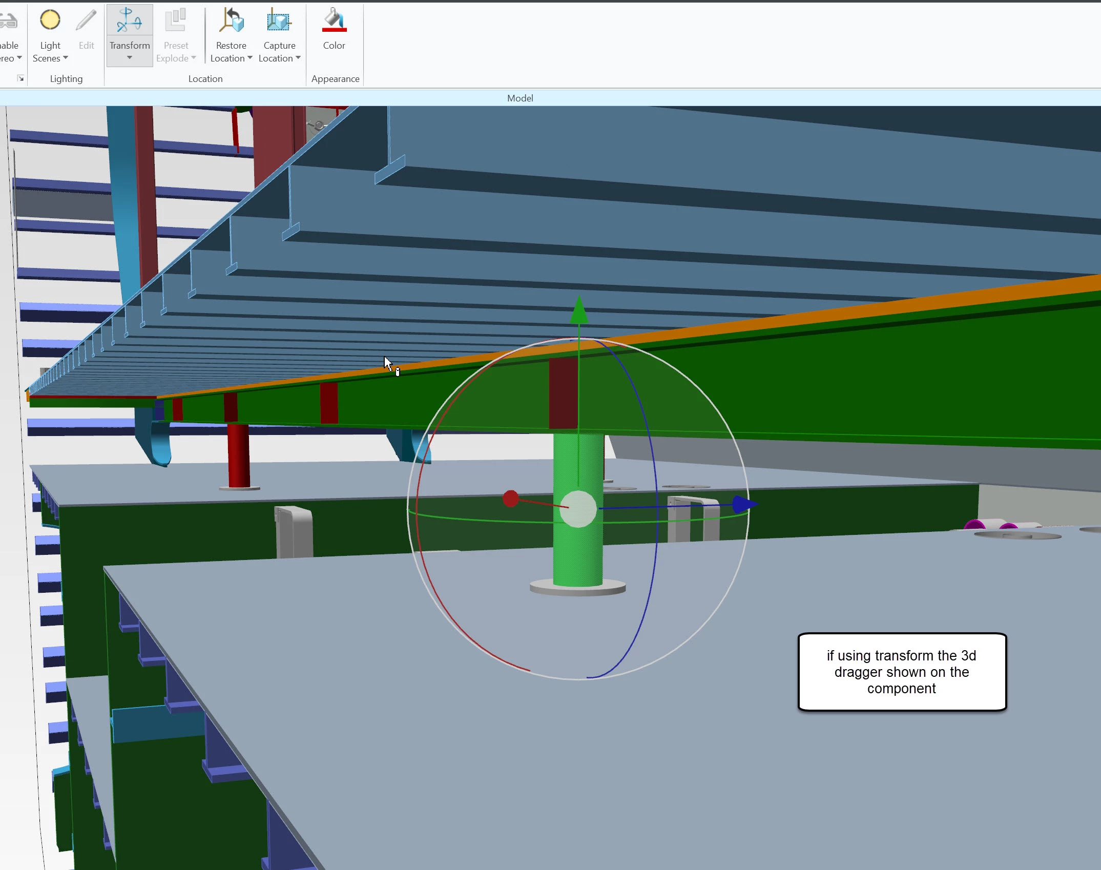

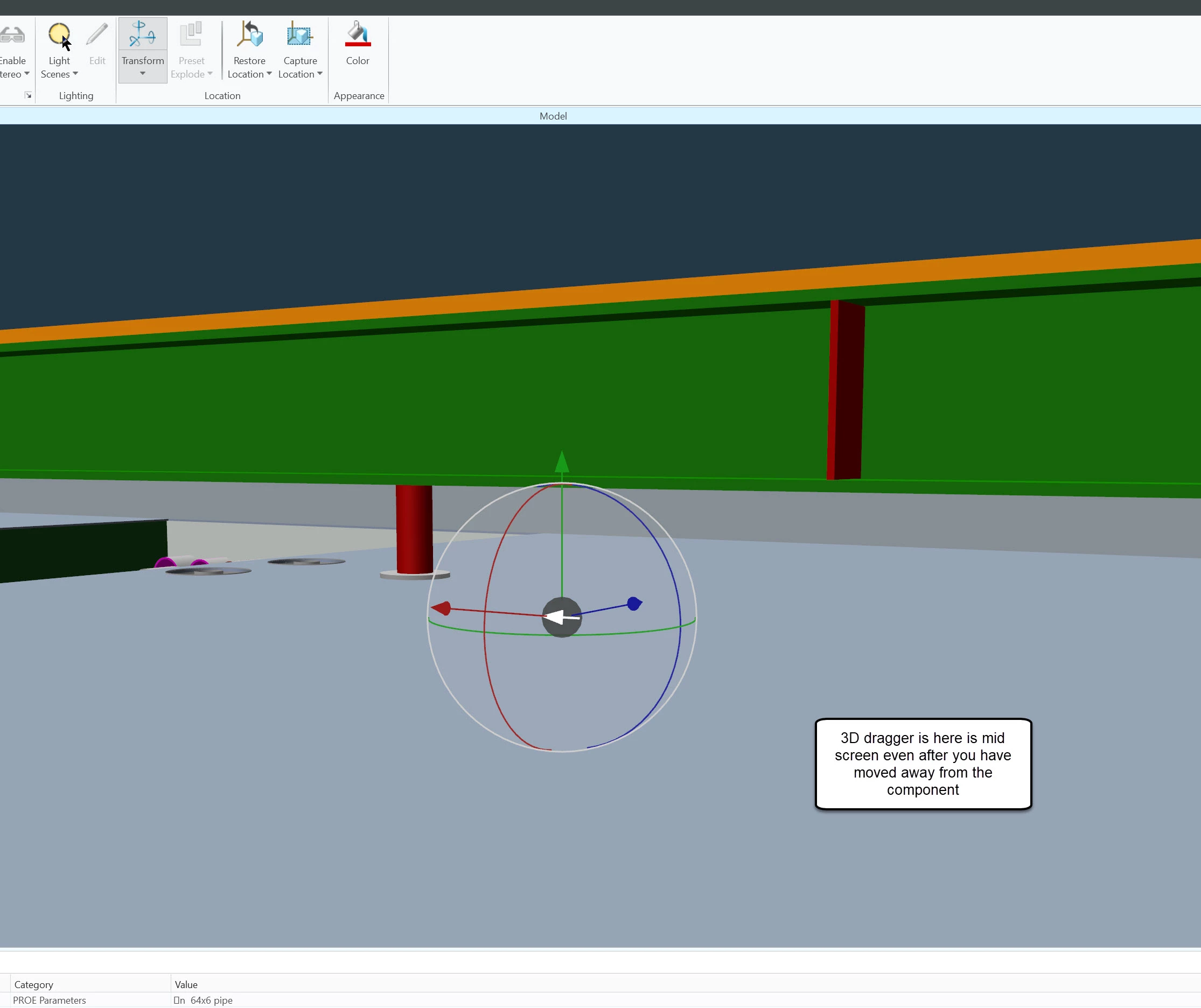

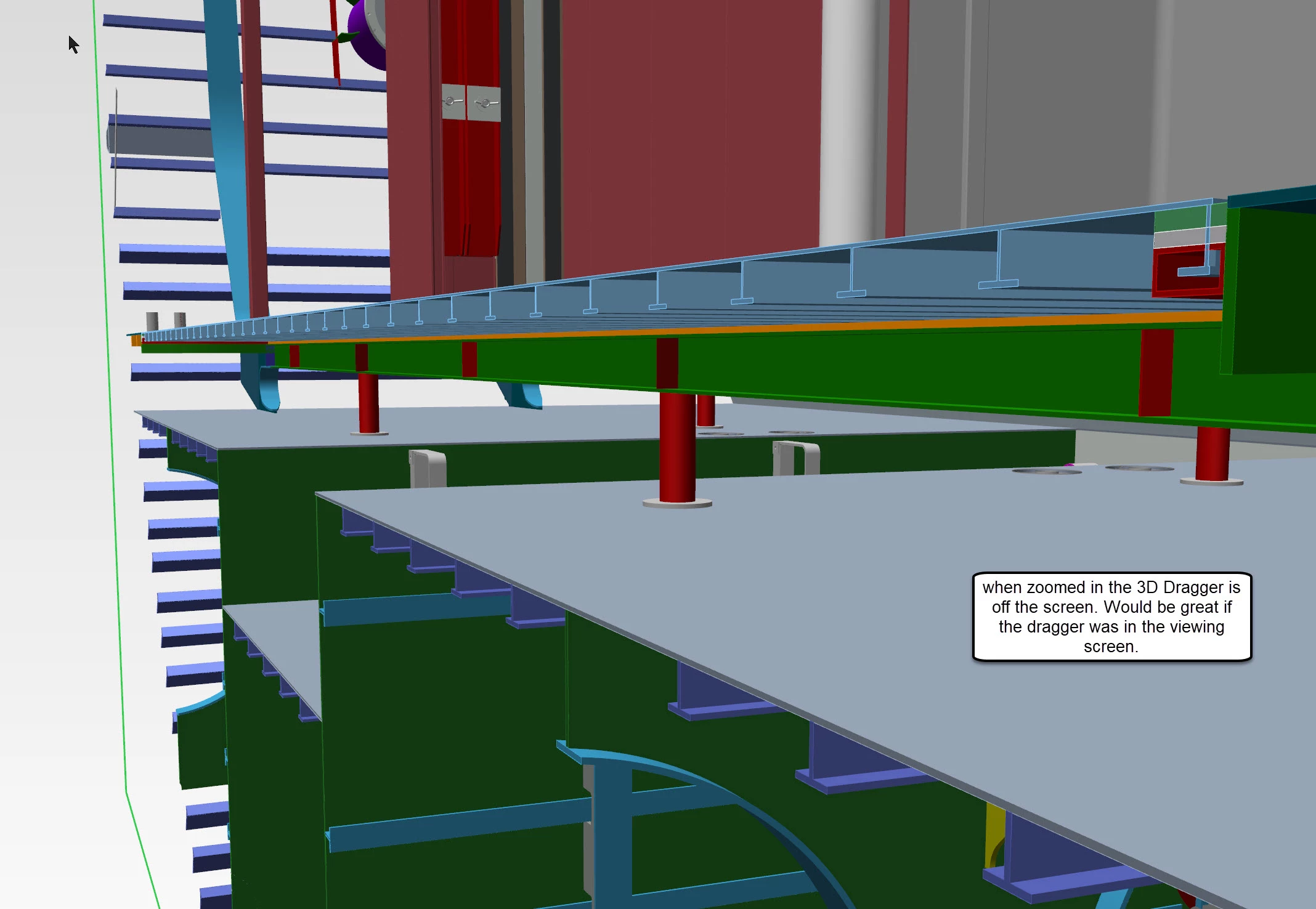

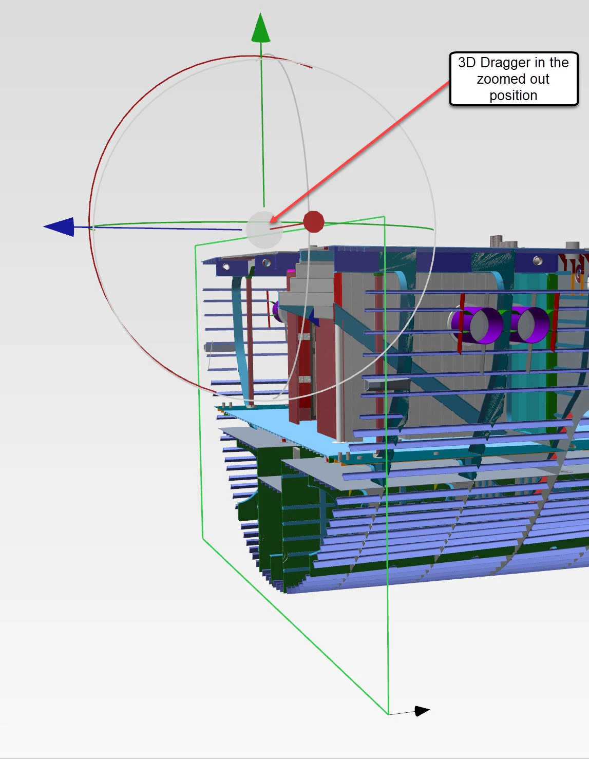

is there a setting in CreoView to make the Section 3D Dragger to be in the Viewing Screen.
Currently when in section and you select the section plane to move the section the dragger is in the middle of the model. in our case the model is 85m long x 20m high makes it very hard when trying to section at component level.
would be good to have the dragger to behave the same as the Component Transform dragger see attached files
