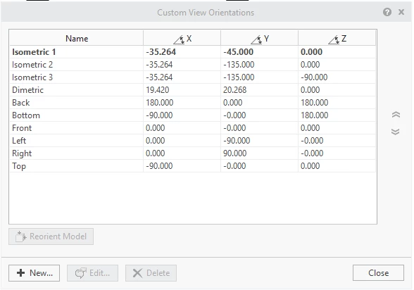

We've noticed that our Custom View Orientations in Creo Illustrate have gone away. If we add new orientations, they do not reappear the next time we open something in CI. They were working prior to 4.0. Does anyone successfully use saved custom views in a version newer than 4.0?
I've attached the Custom Views Orientation window. We're having to update this with every new file. Not fun.
