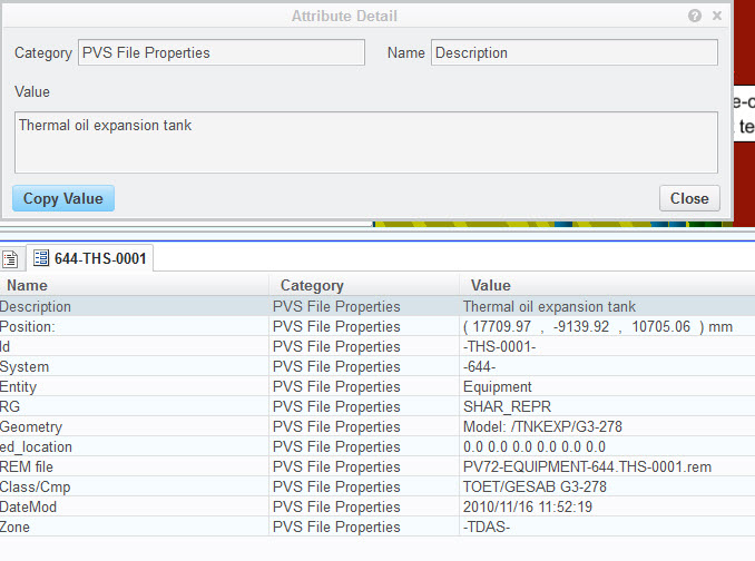

I want to create a callout in Creo Illustrate that shows the Description of the object as the text in the callout.
I can see the description property in the pvs file in Creo Illustrate but I cannot get it to populate the callout.

Congratulations. You've found a little bug
I just tried this myself, and found it will *not* work for PVS File Properties.
It *will* work for other property groups e.g. PROE Parameters, WindchillEPM, WindchillPart etc.
The bug is basically in handling "PVS File Properties", which is a 'magic' attribute group. It is so magic that it doesn't actually have a name - the group category title is, in fact, "" (empty string) and the callout template code is not dealing with this correctly.
