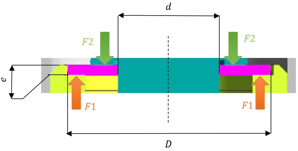

Hello
I do a test simply with a washer, see the sketch enclosed.
I do the simulation with the whole puck and then with half of the puck as well as half of the load.
And I get not the same result to Von Mises:
Entire puck 750.0 [MPa]
Puck half 642.0 [MPa]
When you cut a piece in half to do more than the symmetrical connection.
Kind regards.
Denis

Hi Denis,
Where are your stresses measured?
Do the contact forces balance/add up?
How is your F1 & F2 applied?
atb
December 18, 2016
Good morning Charles.
In reality the force F1 is the support reaction of the force F2.
I have an F1 support that is done on a dia crown. Ext of 42.0 [mm] and dia int of 30.0 [mm].
The force F2 of 30 [KN] acts on a ring of dia ext of 30.0 [mm] and dia int of 23.0 [mm]
Thickness of washer 3.25 [mm]
Cordially.
Denis
