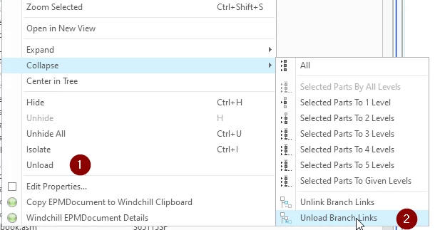

One last thing you can also try is to use with RMB menu selection on the top level assembly/node:
  1. collapse -> Unload branch Links option and / or Unload to take models out of session prior to save.  (This would be similar to the erase not displayed in Creo Parametric as Creo P works the same way, it exports out everything in session even though the model is not shown on the screen)
