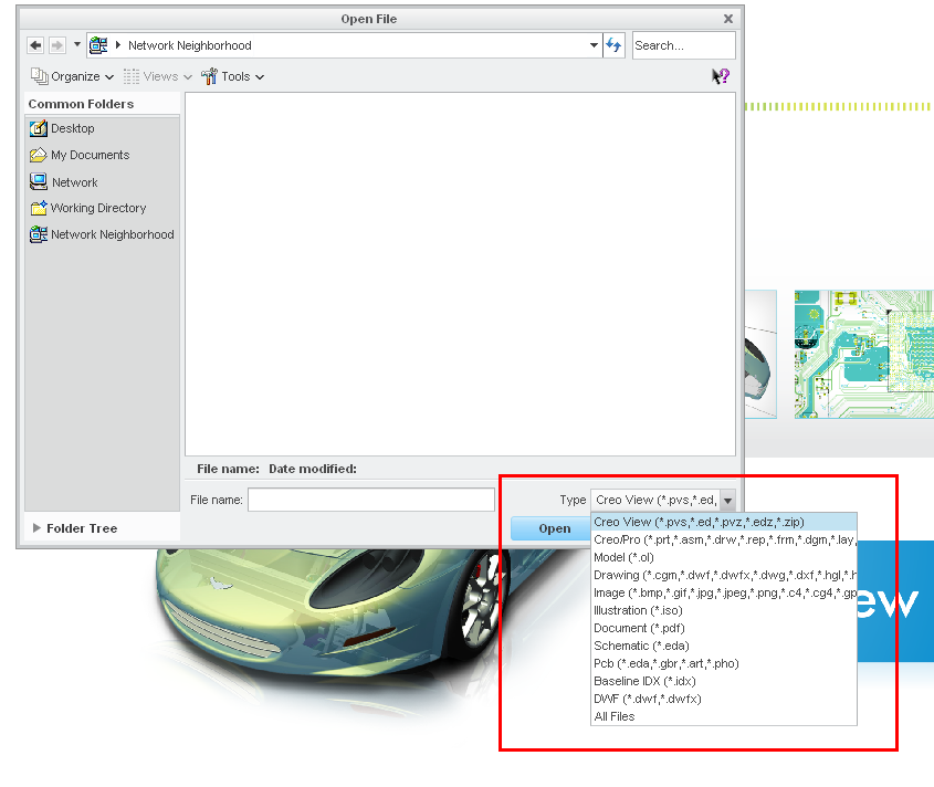

Hi Thomas,
Creo View Express 2.0 (http://www.ptc.com/products/creo/view/express/) supports opening the following format of files (including the format ".drw" from Pro/E):
