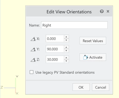

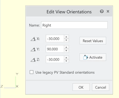

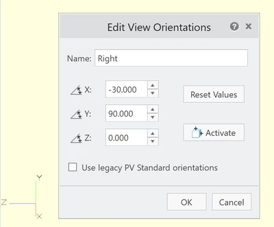

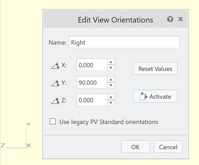

I'm trying to create a custom view orientation. No matter what I do, I can only rotate the view orientation about the Z- and Y-axis, but not about the X-axis.
When I change the numerical value either in the X- or in the Z-angle input box, the view orientation always rotates about the Z-axis and never about the X-axis.
The attached screenshots show different angle values entered in the X- and/or Z-angle input box. It can be seen that the angle always changes about the Z-axis and never about the X-axis.
1. Start: X-angle and Z-angle are zero
2. Changed the Z-angle -> view rotates about Z-axis ✅
3. Changed the X-angle -> view rotates about Z-axis ❌
4. Changed both Z-angle and X-angle -> view does not rotate at all, Z and X cancel each other out ❌
May 13, 2024

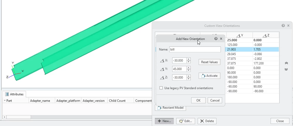

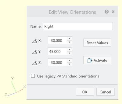

If using something besides 90 value, do you see what you expect?  I think I'm repeating your issue with the 90 on Y and this would require a ticket with Tech Support to resolve.    Our controlled defined Views in our environment only require rotation about two axis.  My views with all three axis changes are working fine.
VecTor10-MarbleAuthor
May 13, 2024
Thanks, I'm seeing the same orientation as in your example.
However, this orientation is also wrong, because no matter what you now enter into the X angle box, the view is actually rotated about where the Z axis was originally (i.e. about an axis parallel to the bottom border line of the below dialog box) and still not about the X axis!
