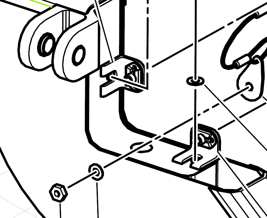

The explode lines always protrude too far over the items, so that both explode lines seem to be in front of the item (see screenshot "before").

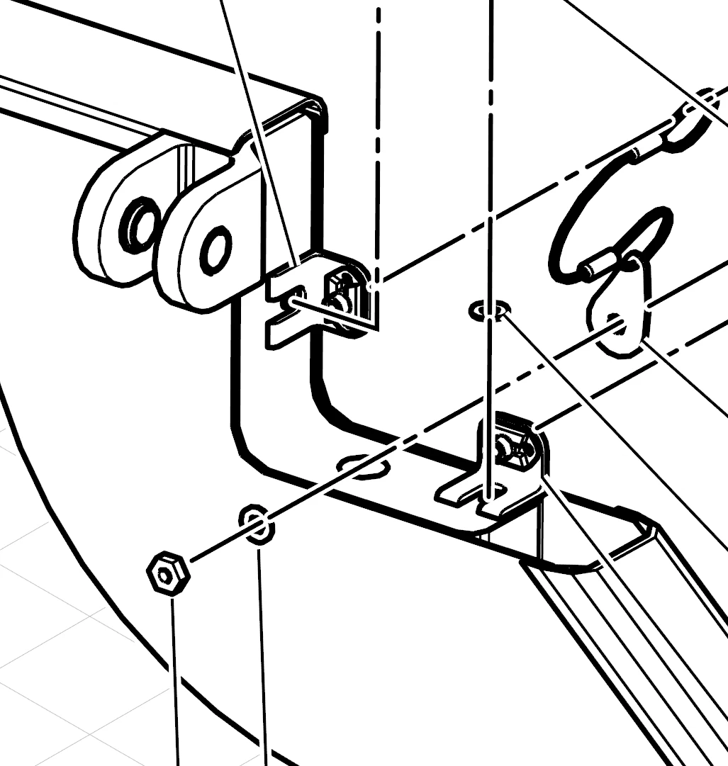

I spend a significant amount of time to manually pull each end of the explode lines to a reasonable position in the 2D drawing (see screenshot "after").
I assume the reason is the white shadow, as without it the explode line would end exactly in the outline of the item.
Is there any setting that can improve this situation ?
