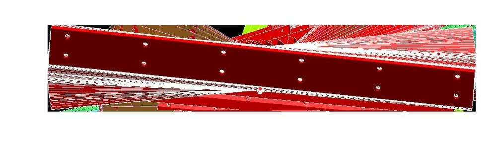

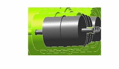

Every model I open has this same distortion. I have uninstalled and reinstalled and still have this issue. This issue occurs on even the smallest file sized models.  Any help would be greatly appreciated!
when i first open the model everything is fine until i drag the mouse courser over the model.
Best answer by Bkitty-APTC
using the environment variable- PV_ENABLE_FRAMEBUFFER_OBJECT=1 did not seem to help the tracing and distortion.
i have solved the issue by disabling openGL.
i did this through system environment variables.
the graphic quality is slightly degraded but barley noticeable
i no longer have the tracing and distortion.
  •   PV_DISABLE_PBUFFER=true
  •   PV_DISABLE_MULTISAMPLE=true
  •   PV_DISABLE_SHADOW=true
  •   PV_DISABLE_MULTI_DRAW_ARRAYS=true
  •   PV_DISABLE_FRAMEBUFFER_OBJECT=true
  •   PV_DISABLE_VERTEX_BUFFER_OBJECT=true

That looks like a graphics driver issue, but I'm not sure what the graphics requirements are for Creo View Lite.  I couldn't find much info on it by searching PTC.com.  I would assume it would be fairly low as it's meant for non-CAD users.
This page only says that it needs Windows XP, Vista or Windows 7.  Maybe it's been discontinued and not usable on Windows 10?

I have updated all graphics related drivers and non related drivers.  this issue came with no warning after months of using creo view with no issues.
 my laptop is dell e7470 i am using windows 10

Dell graphics drivers are sacred!  I have run a PTC qualified Dell laptop with NVidia for a long time and I can tell you one thing... never use NVidia drivers from NVidia.  The only drivers that worked with Creo and Dell was Dell scripted drivers.
Whenever I wanted to try a NVidia driver from NVidia, the driver would also leave "tracers".
Most likely, windows 10 automatically installed drivers from NVidia since it considered them available.  Even Windows 7 is nagging me to update.

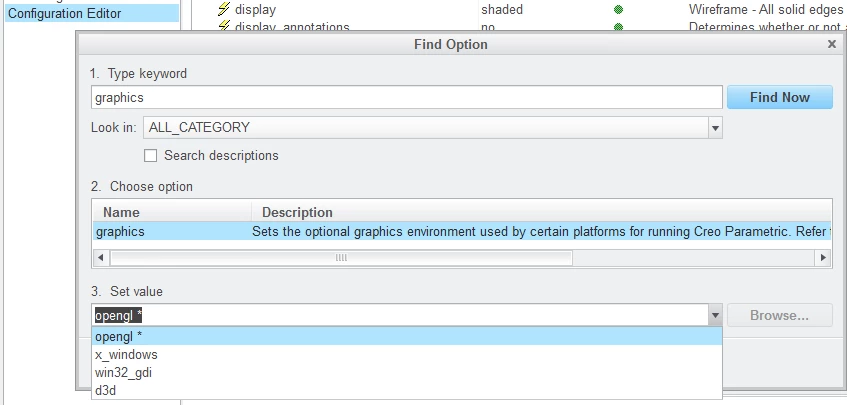

You might also have some luck changing to the win32_gdi setting in config.pro.
Not an elegant solution but it may get you down the road a bit until this is figured out.
