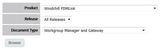

maybe you can start at https://support.ptc.com/appserver/cs/doc/refdoc.jsp page and look for:
In result list you can find ... PTC Windchill Workgroup Manager for Creo Illustrate Administrator's and User's Guide  - English
URL of this guide is http://support.ptc.com/WCMS/files/168666/en/WWGMCreoIllustrateGuide.pdf
