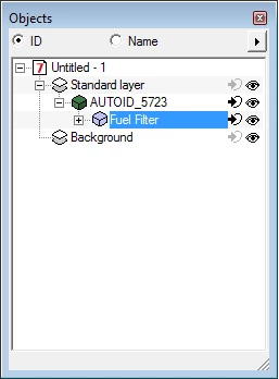

Ramu I wrote:
...Question 1: Whn I open .iges files(Created from catiaV5 i guess) and select single bolt for example, all the bolts in the model are getting selected and getting exploded at a time but i need to select individually as they are grouped in original catia file.Is there any option to select them individually and then explode.Please help...
You can select the objects that you need to be exploded in the "Objects" window (in the main menu select "Window" -> "Show object window"):
