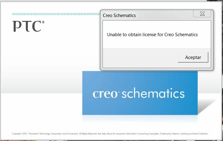

Help! Unable to obtain license for creo schematics 1.0
  • March 16, 2015
  • 2251 views
I have a full license the entire suite, all software work well. I think when I start schematics 1.0 says: unable to obtain license for Creo schematics. I just think schematics 3.0 and Schematics 2.0 works, but I need the 1.0.
above do all procedemientoras to start Schem 2.0. Now me so with Schem 1.0. (try the same procedure you explain me, but this time it turned out)
Best answer by Mahesh_Sharma
Ronny,
License for Creo Schematics 2.0/3.0 is not downward compatible to run older versions. Check https://support.ptc.com/appserver/cs/view/solution.jsp?n=CS59742
