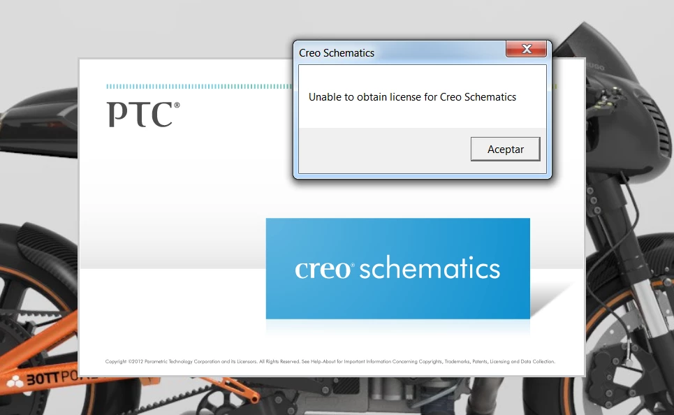

Help! Unable to obtain license for creo schematics 2.0
  • March 13, 2015
  • 13 replies
  • 8167 views
I have a full license the entire suite, all software work well. I think when I start schematics 2.0 says: unable to obtain license for Creo schematics. I just think schematics 3.0 works, but I need the 2.0.
Best answer by Mahesh_Sharma
Ronny,
Try using server IP address in PSF instead of server name (replace RATENCI0 with server IP)
More information is available at
https://support.ptc.com/appserver/cs/view/solution.jsp?n=CS60824

Ronny,
Creo Schematic has its own separate license named CREOSCHEM_License (or something similar). Check the contents of your license file.

March 13, 2015
Ronny,
check the contents of <Schematics_loadpoint>\Creo 2.0\Schematics\bin\schematics.psf file.
The file contains two lines:
ENV=PTC_D_LICENSE_FILE-=LICENSE_PATH
ENV=CREOSCHEM_FEATURE_NAME=CREOSCHEM_License ()
Check both lines.

March 13, 2015
If you have correct license file and still can't run Schematics 2.0 try this:
  1. Go to C:\Windows\system32\drivers\etc folder (etc folder is hidden, btw).
  2. Edit hosts file in etc folder and remember, that if you want to write anything to system folder you need to run editing software, like notepad as an administrator, otherwise you won't be able to save modified file.
  3. Add line in the hosts file
127.0.0.1 <your_machine_name> (there is a space between IP address and machine name)
Save hosts file and exit. It should work then.
What you're doing that way is simply tell the license mechanism that a computer with IP 127.0.0.1 (it's a loopback IP for localhost) have also a name <machine_name>. Thanks to that information Schematics will look for the license in the license server running on your local machine.
