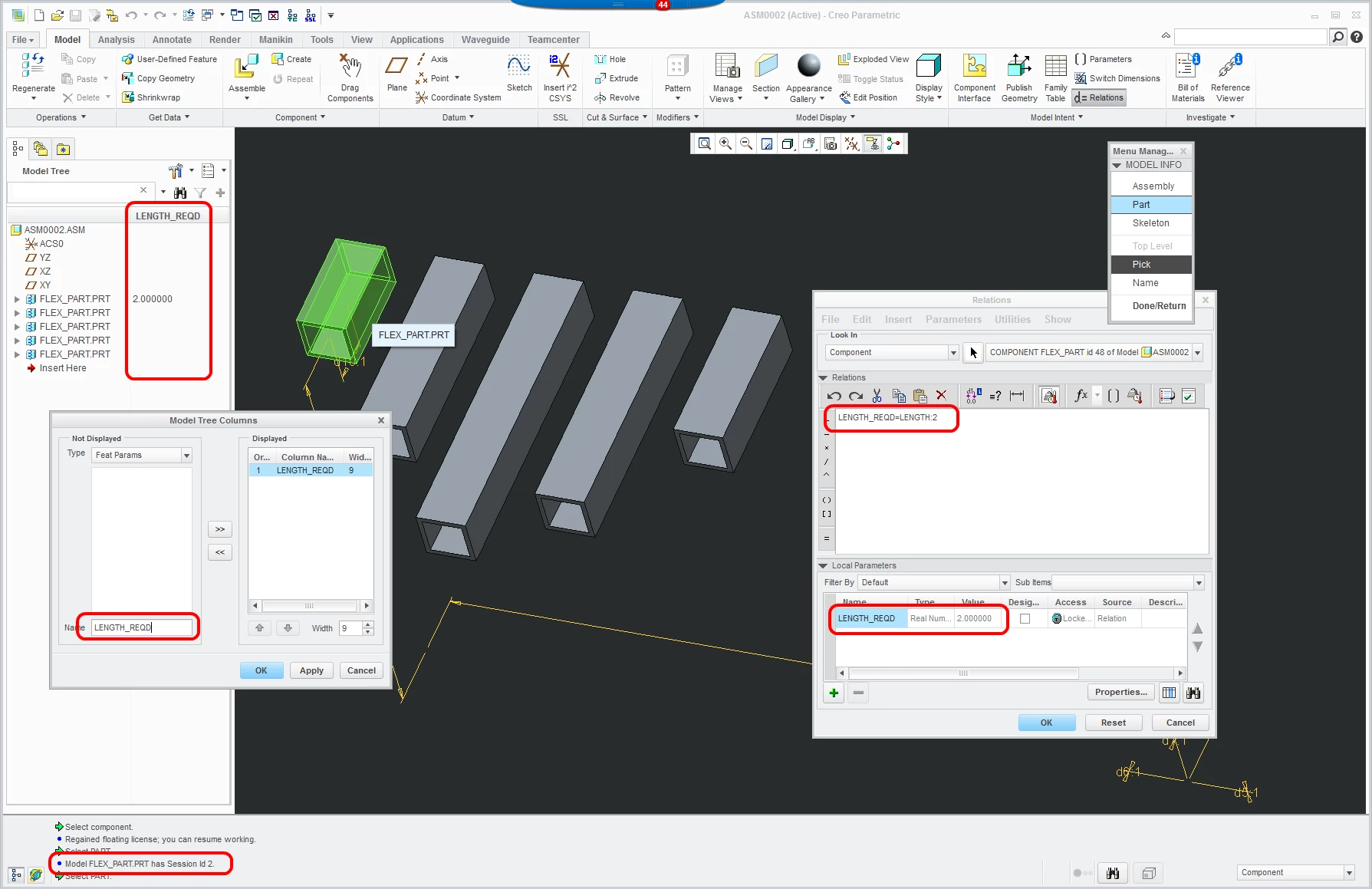

I think we may have stumped PTC on this one, so I'm turning to you guys. We have assy's that use hundreds of occurrences of a flexible model. In the end, we like to determine the total length of the models req'd for the assembly. So far, we've managed to show each length for each occurence by writing a short relation. Trouble is, that relation is dependent upon the session ID of each component, so it becomes a manual and unrealistic endeavor. I hope the attached graphic of a simplified example is enough to describe what we're trying to do, and illustrate the problem.
Thanks for any pointers. This HAS to be possible!
G.

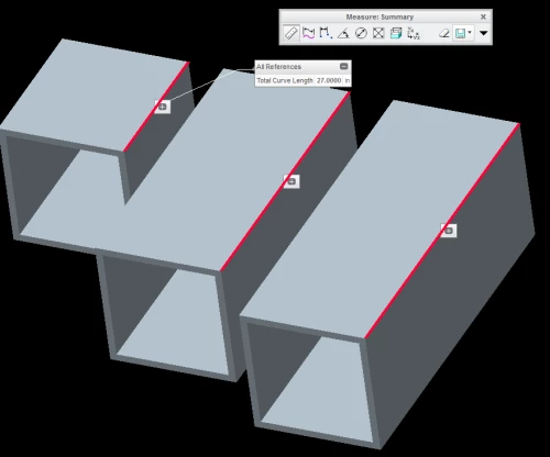

Because this is such a simplistic answer, I'm not sure of the value it may have in the real situation you're trying to solve. Here is what I did.
Create one FLEX_PART.PRT similar to your attached graphic.
Assembled it three times into an assembly. Made each one flexible, similar to what you've done, with lengths of 5, 10, 12.
In the Analysis tab, pick Measure > Summary.
Pick the corner edge of each of the three FLEX_PART, as shown here:
[cid:image001.png@01CF7FC7.D960E860]

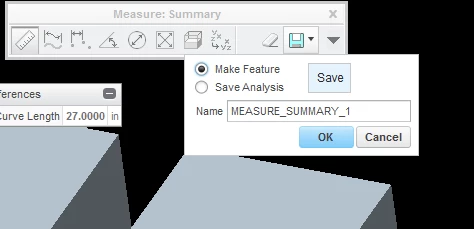

Pick the Save icon from the Measure: Summary window. (You can see the Curve Length is correct based on the flexible values I chose for these parts.)
[cid:image002.png@01CF7FC7.D960E860]
Pick the OK button to make it a feature in the model tree.
[cid:image003.png@01CF7FC7.D960E860]
