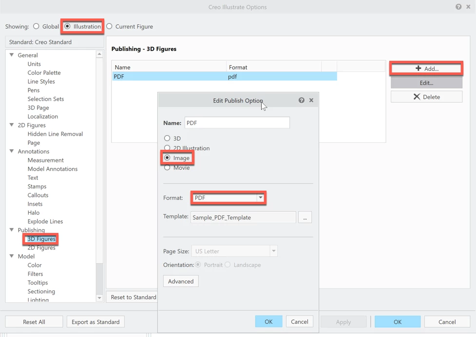

Follow the procedure below as illustrated in Figure 1 (attached):
  • Go to File ==> Options
  • Click the Illustration category
  • Click 3D figures (or 2D figures)
  • Click Add
  • Select Image and select PDF
  • Click Ok and Click Ok

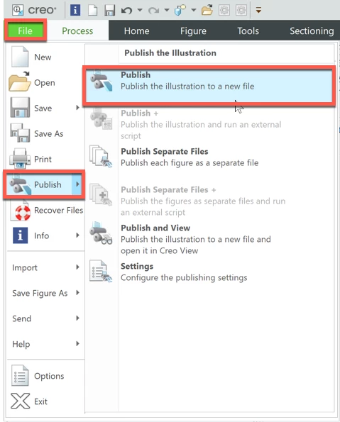

To Publish the figures to PDF inside a PVZ follow the procedure as illustrated in Figure 2 (attached):
  • Click File
  • lick Publish and click Publish
