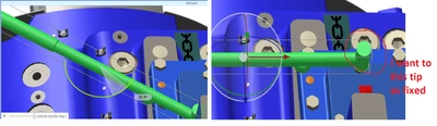

I'm trying to create some sequence in creo illustrate, I have added wrench from object. When I rotate wrench it rotate at center, I want to rotate wrench with tip of wrench is fixed to bolt. PFB PNG for reference.

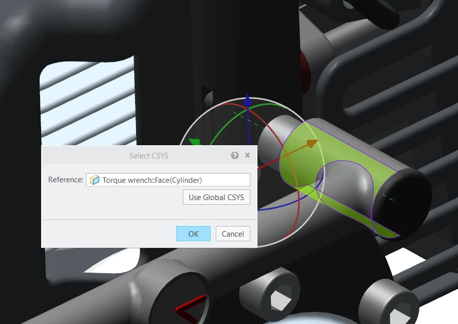

To change the the csys you need to:
  1. Select the part
  2. Right click and select "Location>Select csys"
  3. You can now define the new csys
For the wrench I would first select the cylindrical face (which then shows the axis)

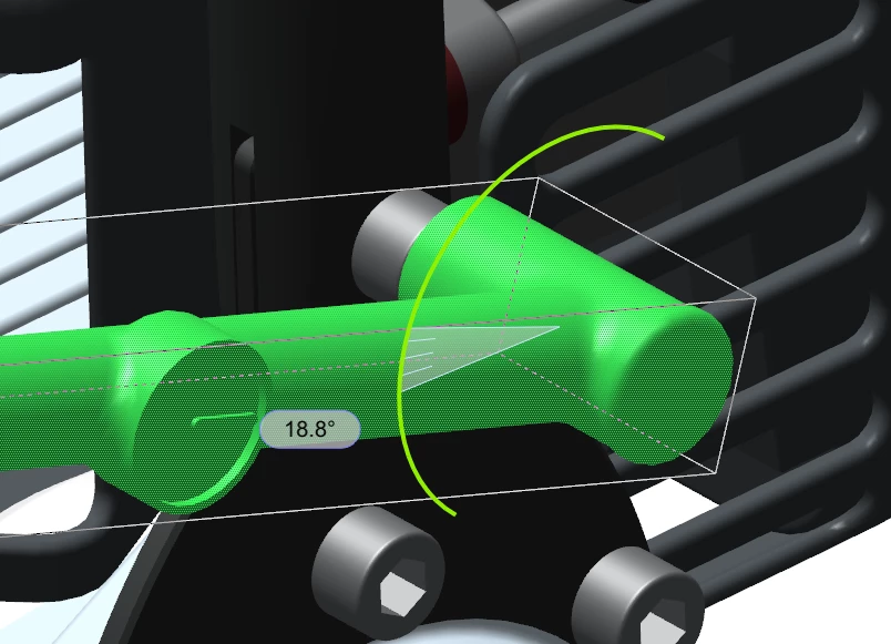

Then select the axis you want to rotate around.
Rotate around new csys.pngHope this helps.
  1. Select the part

Thank you @agarland . It works.
