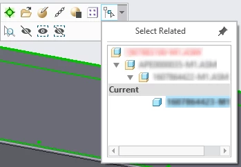

@JosephTC
You can also use the "Select Related" feature.
It can be pinned next to the model tree as well.
Select RelatedSelect Related
